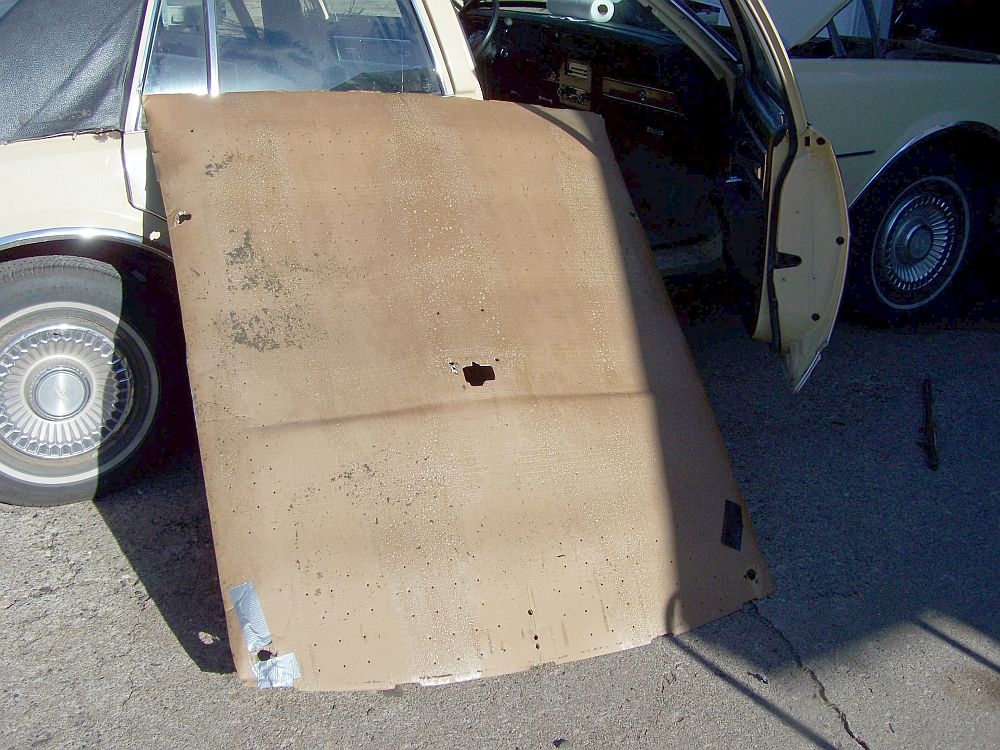

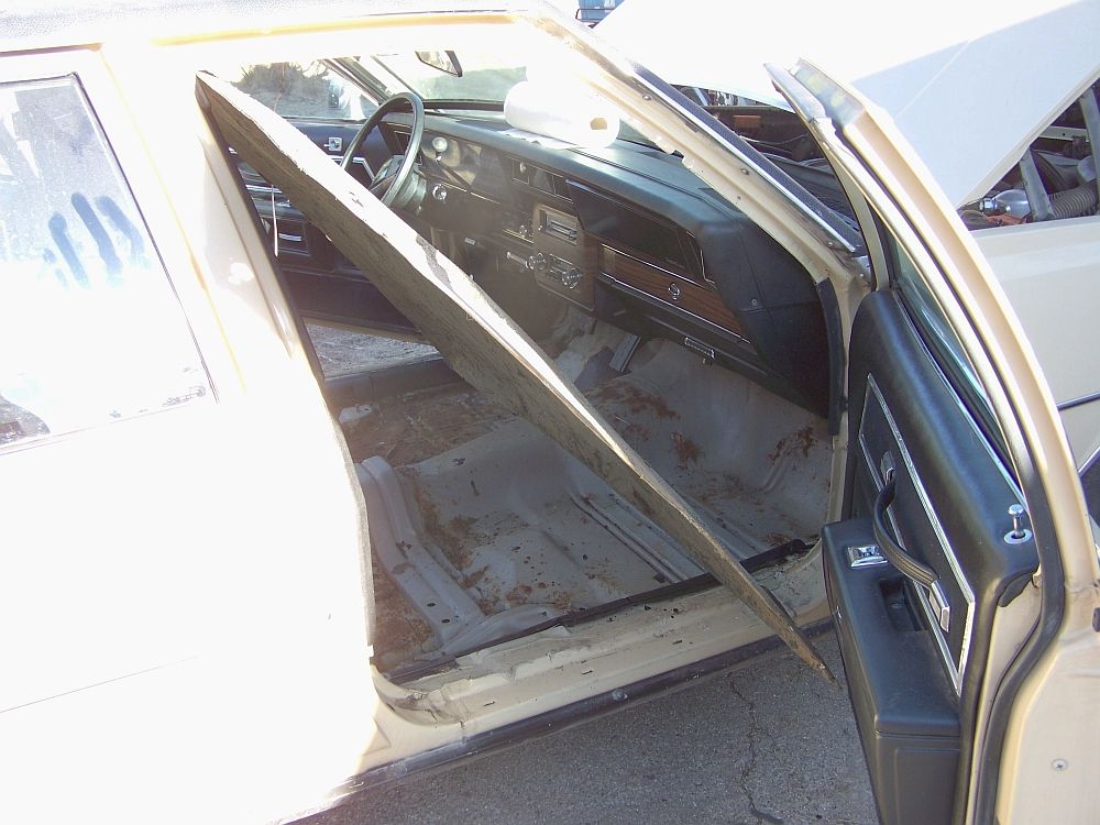

    Well, the car is back out of the garage now that nicer weather has arrived.  I have new carpeting to install so I pulled the seats and found that the carpeting and padding underneath it is completely saturated.  It was mostly wet on the passenger side and I'm guessing I have a leak up front somewhere.  Shouldn't be too hard to find with as wet as everything was after sitting all winter inside a garage.
    Anyway, while the seats and carpeting are out I decided to pull the headliner board down and see if it would fit out one of the doors.  I had measured everything and it seemed like it would fit but I figured the passenger front door might have to come off to do it.  Surprisingly, once I pulled the board down and got it turned sideways it came right out without removing the door.
    So, it can be done.  While I have all of the seats and the carpeting out I don't see any reason why the headliner board wouldn't come out with just the front seat removed.
    I took some pics showing it coming out the door opening:

    Now I just have to figure out a good way to fix the part that is cracked on the passenger front area around the visor.  I taped it up while removing it to keep it from breaking completely off.  I would like to be able to use this board for the new headliner material.

    Wow nice, when i had my 4 door i couldnt get the board out, but i didnt take the seats out. So thats good, it can be done.

    Excellent news! Thanks for the confirmation. I had a sneaky suspicion it would come out through a door, but wasn't 100% sure. Also nice to know that only the front seats have to be removed. That board is very usable and looks to be in good shape overall. Be sure and remove all of the leftover fabric and the foam off the board. I always use a stiff plastic bristle carpet brush and gently brush off the majority of it lightly, then using a towel to rub the rest of the foam off. Any old foam left behind will prohibit adhesion of the new foam backed material.
