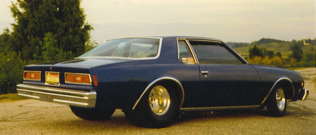

    Soon after I graduated from college, I decided to get a little wilder with it.  This was on the tail of the Pro Street movement.  It looked great for the times, however by the late 90's started to get outdated:
    Project Impulse Impala1997

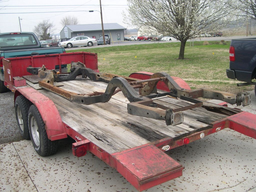

    Then around 2005 it was time to take it to the next level:
    Project Impulse 1
    Project Impulse 8
    Project Impulse 14
    Project Impulse 17
    Project Impulse 22
    Project Impulse 26
    Project Impulse 27
    Project Impulse 30
    Project Impulse 42
    Project Impulse 47

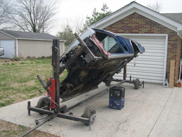

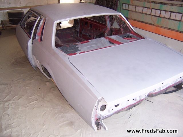

    In the blasting booth:
    Project Impulse 49
    Project Impulse 50
    Project Impulse 61
    Project Impulse 62
    Project Impulse 1977_Impala_01-41
    Project Impulse 63

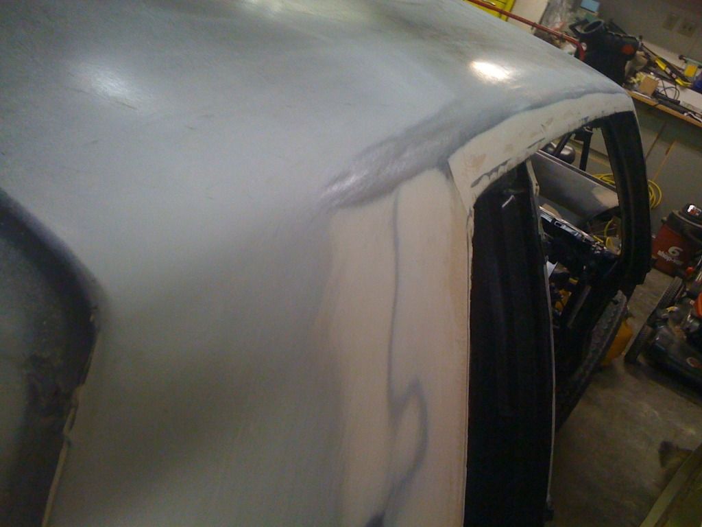

    Time for Epoxy 9He stripped off SEVEN layers of paint!!
    Project Impulse Carpics052
    Project Impulse Carpics001
    Project Impulse Carpics044
    Project Impulse Carpics026

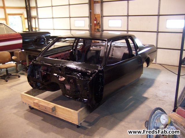

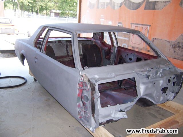

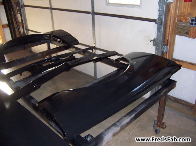

    Time for a clean shave:
    Project Impulse Carpics005
    Project Impulse Carpics023
    Project Impulse Carpics013
    Project Impulse Carpics019

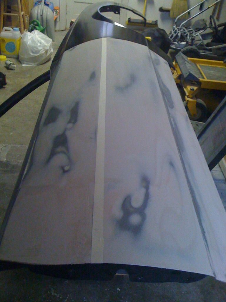

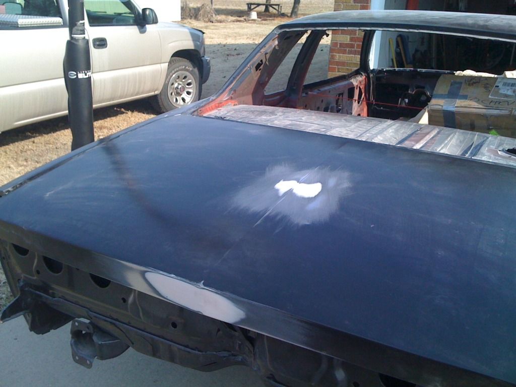

    Another Teaser. Hey you can't do bodywork in the winter!
    Project Impulse Iphone4061

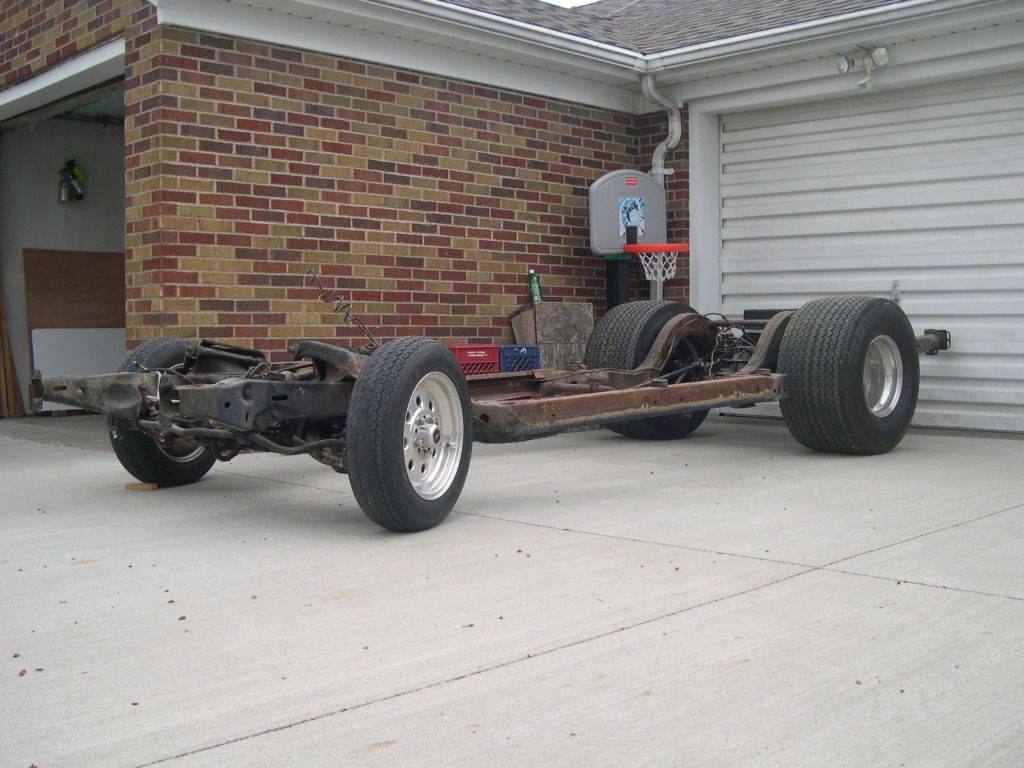

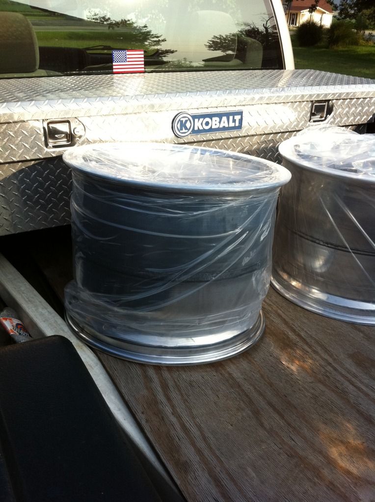

    Yes this is in the bed of a full size Silverado Truck.
    Project Impulse Rims002
    Project Impulse Rims004
    Project Impulse Rims008
    Project Impulse Carpics32512008
    Project Impulse Carpics32512012
    Project Impulse Carpics32512006
    Project Impulse Car2044
    Project Impulse Car2018
    Project Impulse IMG_1281_zpssdi8datc
    Project Impulse IMG_1288_zpsubiw9iaa
    Project Impulse 88538e4b-985f-48a9-abac-982d2a5cd4b5_zps4yktzpl7

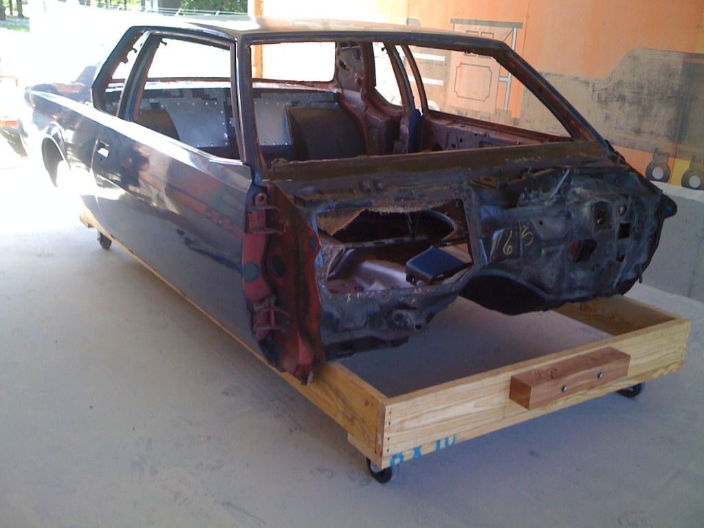

    Word to the wise. DO NOT do your final body sanding on a cart like this!!. Although it worked great to roll the car around and work on it. The body WILL flex once the wait is on the wheels and not the frame. Just a helpful hint. How do I know, I know!!!

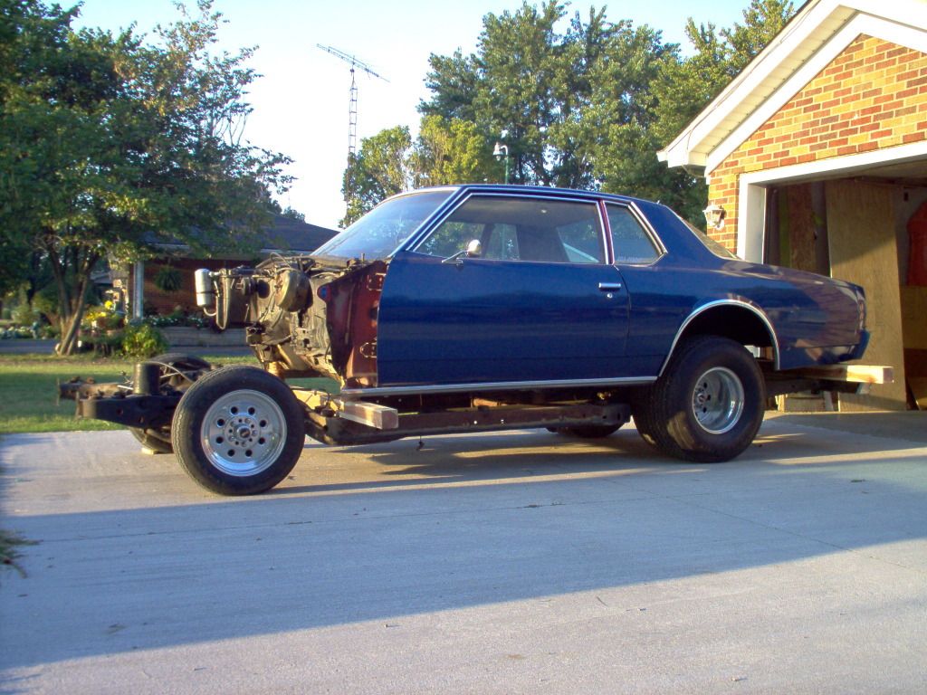

    Post  IMPALA MAN on Sun Oct 11, 2015 9:56 pm

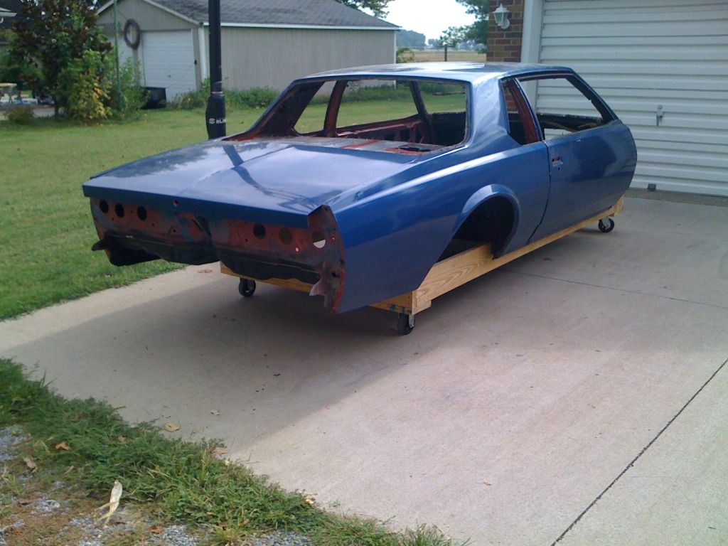

    Yes that is 69 Camaro gills grafted into the quarters and yes, the rear wheels are coming forward about 1.5" to 2".

    She's coming along nicely! I'm loving the quarter mod.
    I've always been a fan of front fender vents too.

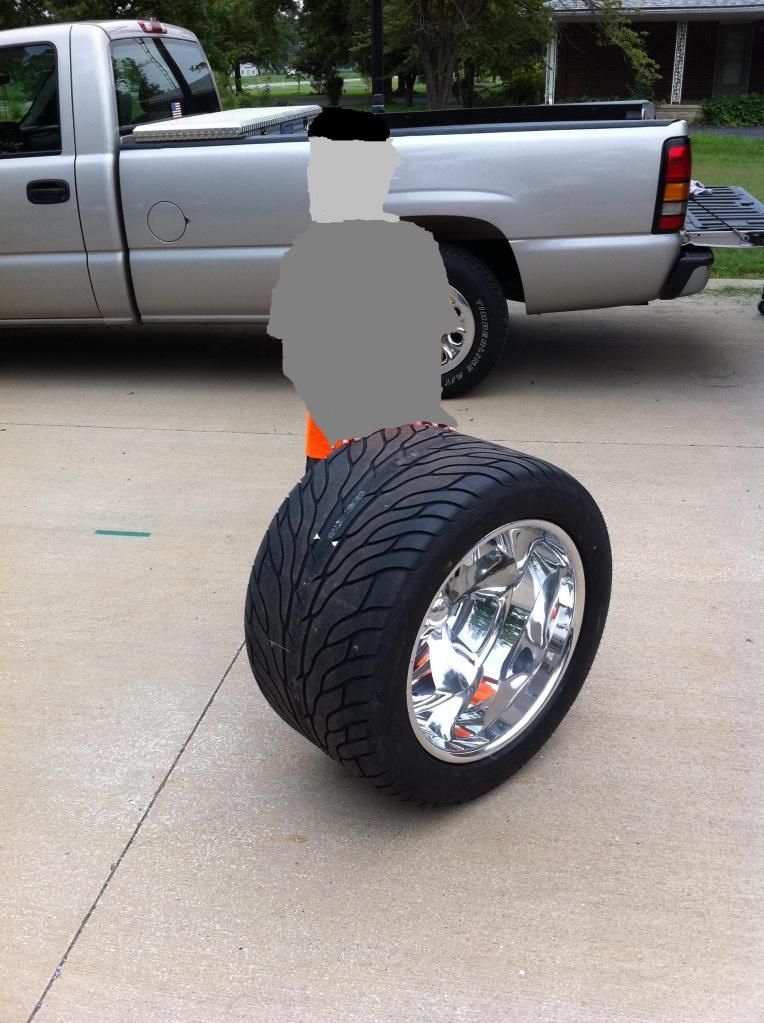

    These are 20 diameter X 15 wide. There was a set of them on Lateral G for sale. Boyd Junkyard Dogs

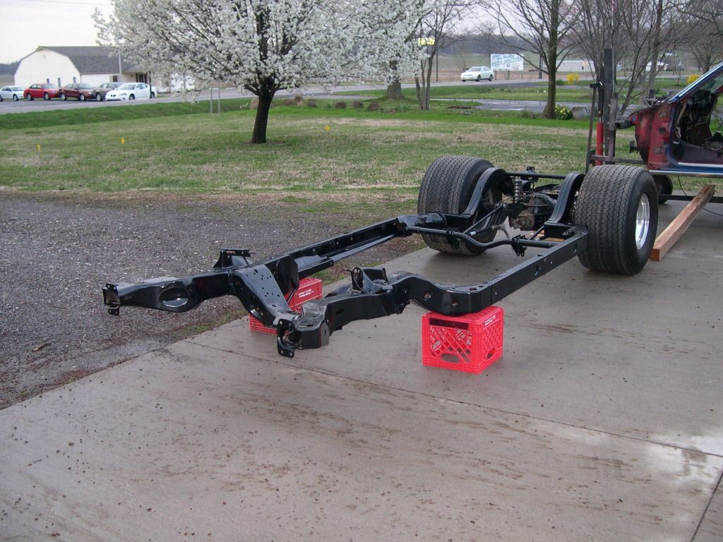

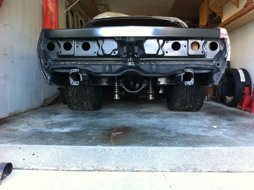

    I think I lowered the front about two inches. It's tough how I had to get the look. Here is how. First I knew to get a good rake, because the car was so long I would have to get the front as low as I practically could.
    Here was the parts and how they played out.
    First you want to try to get the top of the rear rims to be within 1-2 inches from the wheel well. This gives the car a low look no matter how high or low it really is. Then lower the front end to get the rake you want. It took 20" rims to get there. It could have used 22s however I noticed the only company making tires for the rims was Mickey Thompson. They were offering 22" tires, however they were on the garage sale, which most of the time means they are soon to be discontinued. That be suspected, I really didn't want to end up with two 22 X 15 $1500 hose reels.
    On the power plant, it's a 350 Tune Port out of an 86 Camaro. It's a little built, however once I get it going and maybe a power tour on it, I'll probably get a crate long block or maybe an LS Engine. I'm not big on having the biggest baddest engine. I just want to cruise and have fun.

    The rear are 20 X 15 wide rims and the front are 18 X 9 wide. Boyd Wheels and Mickey Thompson Tires.
    It takes a lot to fill up the wheel wells!!
    Thanks for the compliments!!
