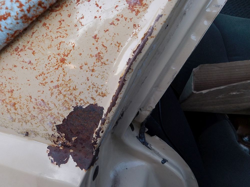

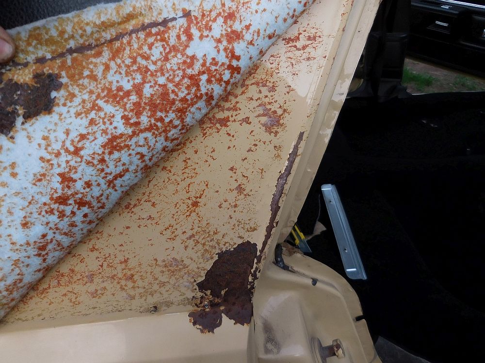

    I started this project early last spring as soon as I got the car out of the garage after putting it away for the winter.  Unfortunately it turned into a much bigger job than I anticipated and much of it got put on the back burner in favor of other projects.  When I got the seats and the old carpeting out I found it was saturated even though the car hadn't been outside in six months.  That was my introduction to the common leaking heater box issue that is apparently so common on these cars. I pulled that assembly out and resealed everything following the advice found here in several different threads.  Fortunately the rust under the carpeting wasn't too bad, but it needed to be fixed before putting the new carpeting in.
    New Carpeting, Headliner finally installed Floor
    I removed as much of the rust as I could and used a rust encapsulator from Eastwood to hopefully seal up anything that was left.  I'm skeptical about it but time will tell how well it works.  On top of that I put some spray-bomb spatter paint to make it look halfway factory even though it will be covered with the carpeting.

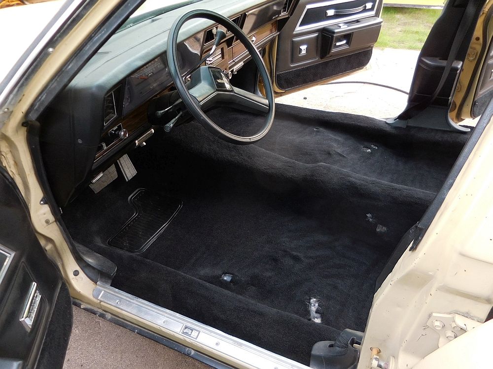

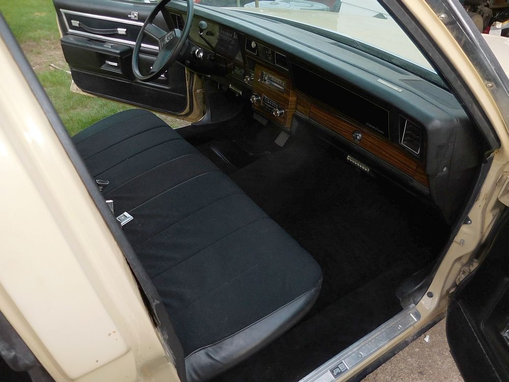

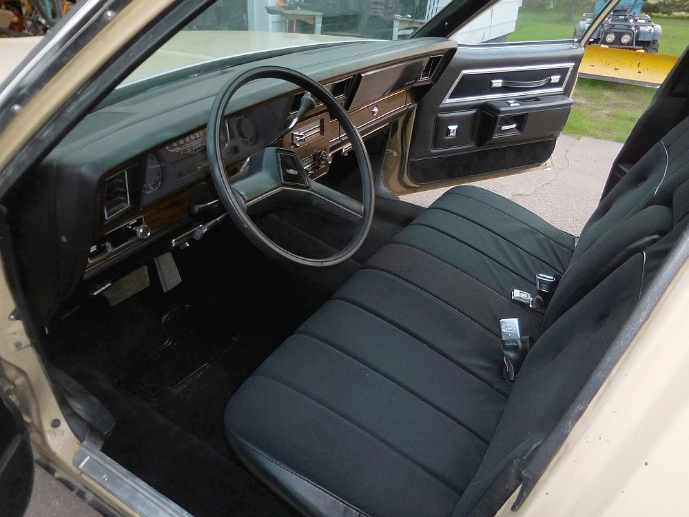

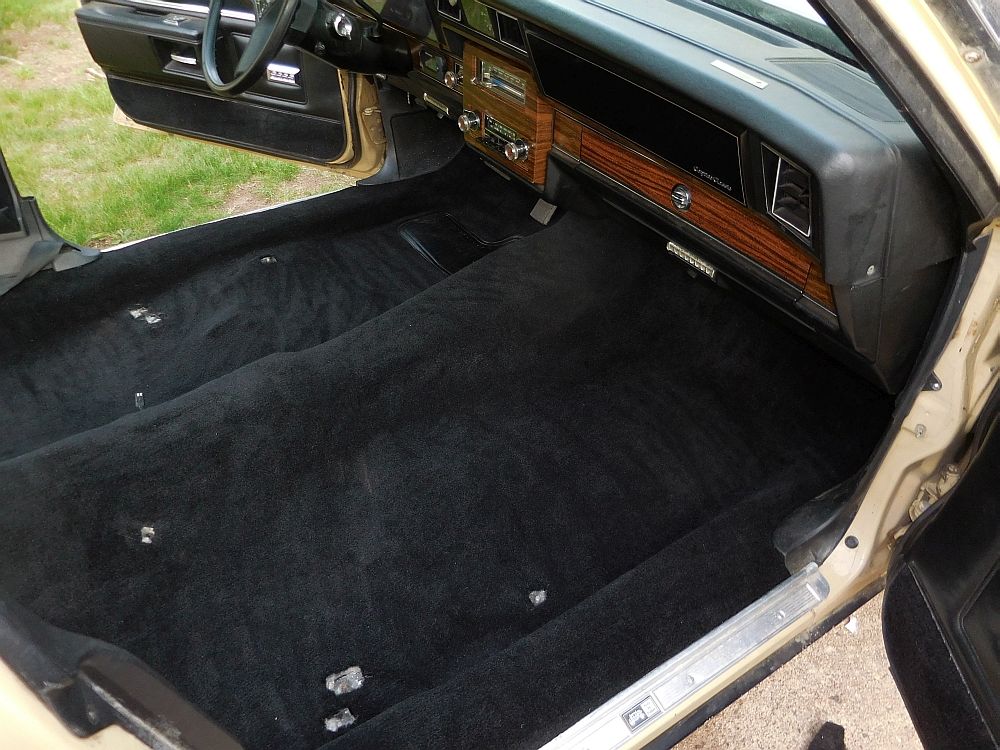

    I got my new carpeting and headliner material from stockinteriors.com and I am happy with the quality of everything I got from them.  I've been working on this a little bit at a time and I finally got everything trimmed and fit enough to get the front seat back in so I can move the car around easier.
    New Carpeting, Headliner finally installed Carpet4
    New Carpeting, Headliner finally installed Carpet3
    New Carpeting, Headliner finally installed Carpet1
    New Carpeting, Headliner finally installed Carpet2

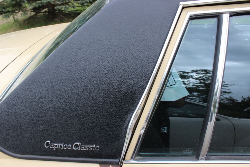

    I still have some repair work to do on the right quarter panel so I'm not going to get the back seat and the rest of the interior back together until that is done.  There is some damage on the C-pillar and right rear door seems about the height of a mailbox.
