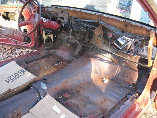

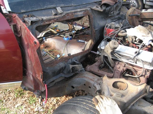

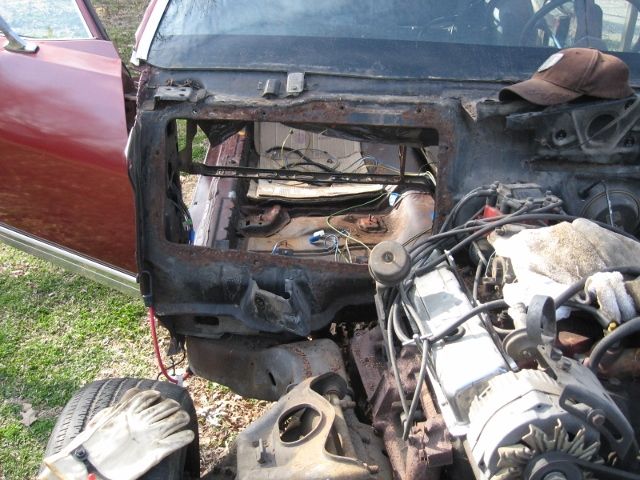

    Progress this weekend:
    First, here are the pics of the air box removed:
    '79 Chevy Caprice 2-door then and now... - Page 4 IMG_1686640x480_zps18023b34
    '79 Chevy Caprice 2-door then and now... - Page 4 IMG_1687640x480_zps0d2942eb

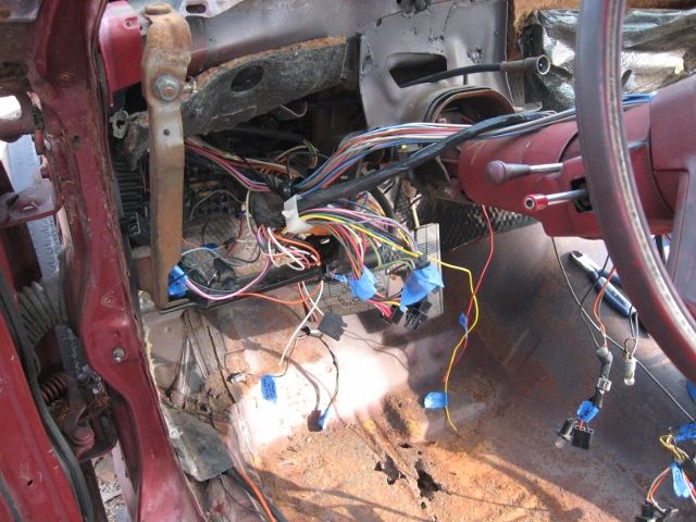

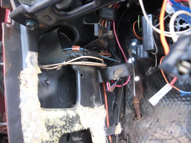

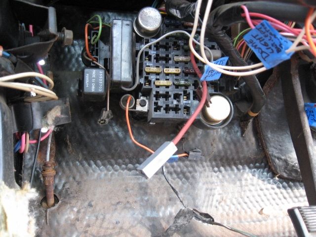

    Finally got all of the wiring labeled and ready to pull it all out:
    '79 Chevy Caprice 2-door then and now... - Page 4 IMG_1689640x480_zpsd5281cb0
    '79 Chevy Caprice 2-door then and now... - Page 4 IMG_1690640x480_zpse9474253

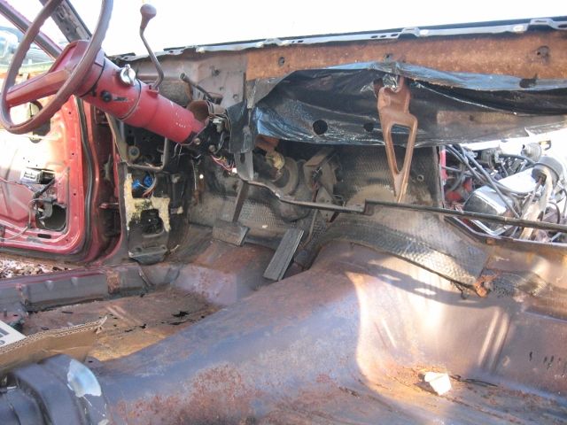

    Emergency brake assembly removed:
    '79 Chevy Caprice 2-door then and now... - Page 4 IMG_1691640x480_zpscf6819b5
    All wiring and fuse box removed:
    '79 Chevy Caprice 2-door then and now... - Page 4 IMG_1696640x480_zpscd1304b8
    '79 Chevy Caprice 2-door then and now... - Page 4 IMG_1697640x480_zpsb9f6fbea

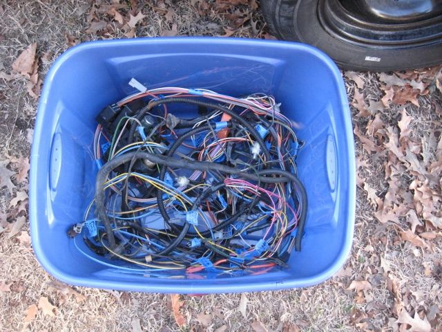

    And.....here it all is:
    '79 Chevy Caprice 2-door then and now... - Page 4 IMG_1698640x480_zpsb9bfab43
    Lots of wire and looks like a mess, but I know where it all goes and that's all that matters. I'll be going through it all at some point checking and cleaning the wires and fixing a few pinched ones I found.

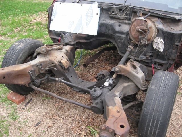

    Finally, bulkhead and engine harness completely removed:
    '79 Chevy Caprice 2-door then and now... - Page 4 IMG_1699640x480_zps7eb7b611

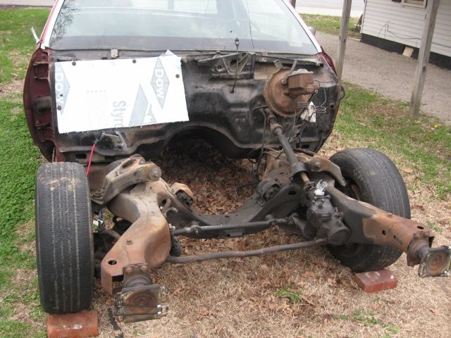

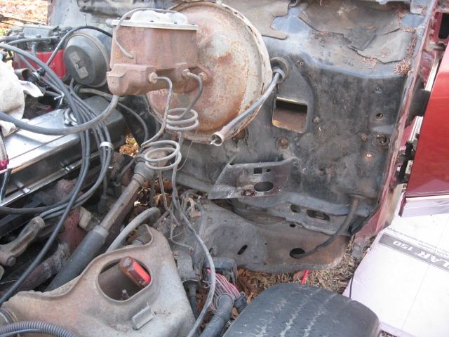

    The only wiring left to remove is the power window and locks harnesses inside the doors. I probably won't remove that until I get ready to take the doors off which will be awhile anyway.
    I'm now ready to remove the brake assembly, brake booster, master cylinder, accelerator cable and pedal assembly and of course the engine is ready to come out any time now. Full speed ahead.
    I can't wait to actually start reconditioning, repairing and repainting things.

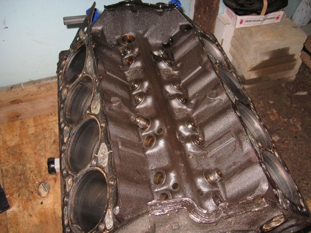

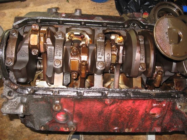

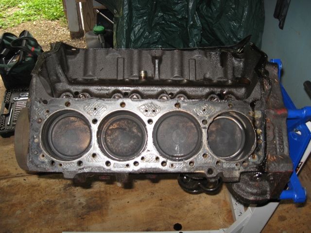

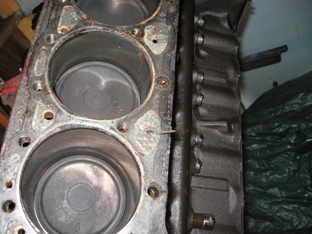

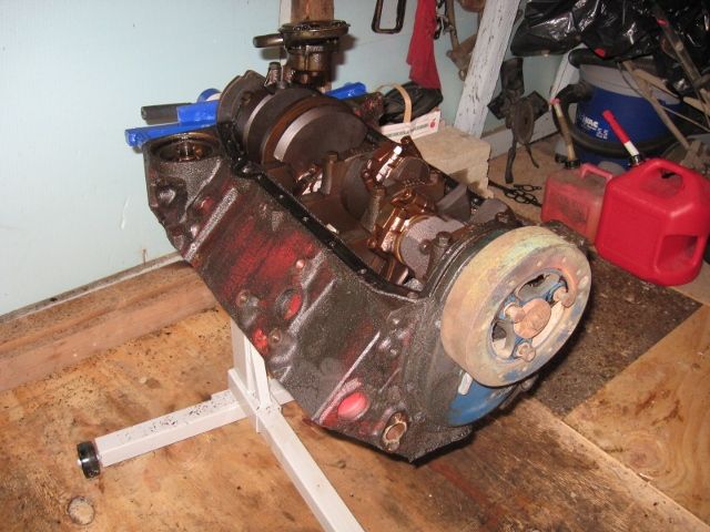

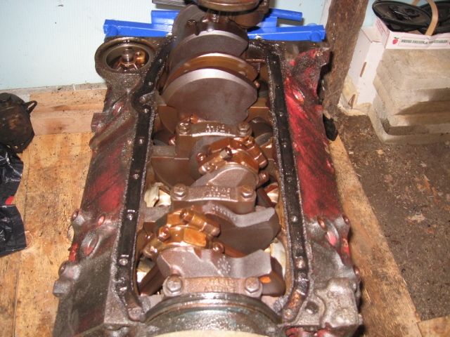

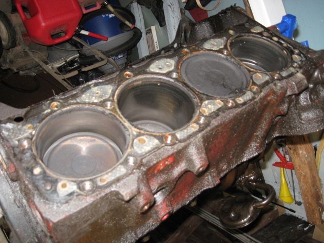

    I'm going to rebuild that engine since I found out it is a 350. When I first bought it, it would start and idle fine, no misfire and even rev up good, just had a loud low end knocking sound. I suspect it's a broken rod. I'm pretty confident with the way it would still run that there isn't anything wrong with the block and heads. It didn't even smoke or anything. If it would have been a 305, I would have tossed it and probably went with a crate 350 or built my own. I think this one is a good solid foundation for a good mild 350 build. I'll know for sure when I get it out and on the stand and tear it down. I'll document that as I go as well.

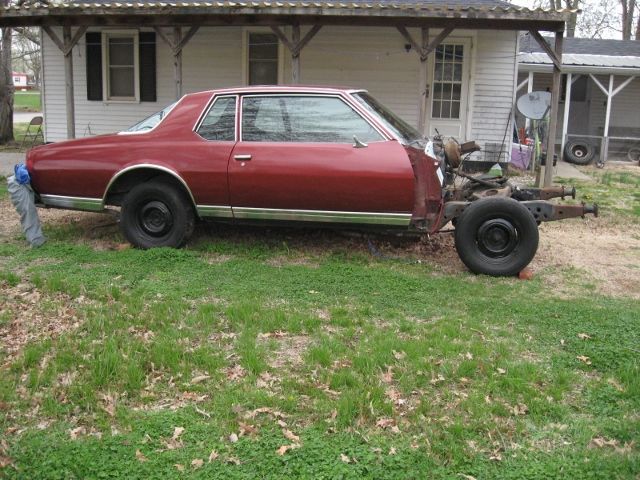

    Post  solo79 on Tue Apr 15, 2014 8:50 pm
    Well, time for an update...finally!
    Something is missing:
    '79 Chevy Caprice 2-door then and now... - Page 4 IMG_1700640x480_zps99c3da59
    Where did it go?
    '79 Chevy Caprice 2-door then and now... - Page 4 IMG_1701640x480_zps982be04c
    '79 Chevy Caprice 2-door then and now... - Page 4 IMG_1702640x480_zps083971da
    '79 Chevy Caprice 2-door then and now... - Page 4 Empty Re: '79 Chevy Caprice 2-door then and now...
    Post  solo79 on Tue Apr 15, 2014 8:58 pm
    You'll notice that at some point, someone cut the factory battery cable and conveniently left some of it on the frame. It came out pretty easily except I had to cut the exhaust off. The bolts and nuts are rusty blobs that wouldn't budge even after soaking in penetrating oil for weeks. The only real trouble I had was the brand new engine stand. While rolling it not even 2 feet, the front wheel bearings fell out and it almost tipped over on me. I had to rob the front wheel off my other stand and put that one on blocks for now until I can take this wheel and the receipt back and get another wheel. You just can't get good quality stuff anymore. The engine is safe inside the building and ready for tear down.
    I bet you're wondering how I got that engine out of there in grass? Easy. I built a 3/4" plywood road from the building to the car for the hoist and stand. Who needs concrete and a garage?lol Worked flawlessly, well except for the cheap caster wheel.

    Post  solo79 on Fri Apr 18, 2014 7:32 am
    GM B-Body Forum wrote:Haha cool. The front end looks surprisingly clean, and rust free considering what rest of the body looks like. I cant wait to do my frame off resto, but it wont be happening anytime soon. I feel like i asked this question before, but i cant remember, so here it is. You said your doing a frame off, are you planning on doing it there at home? If so how are you planning on removing the body? Ive been thinking and planning about that for months, about the "safest" easiest way possible. I see alot of floor jacks, jack stands and 2x4's in my future lol.
    I too have been trying to come up with ideas over the past year and I think I've settled on building two timber A-Frames out of 6x6 timber and lag bolts.  I used to work for a construction company and we built a lot of timber frame houses and structures, so I've got the knowledge.  It might be a bit overkill, but it will support a car body.  They'll be tied together with cross bracing and it will have large 4" thick lag bolted wood plates to bolt the car body to on each end on some kind of rotating assembly.  I'm still drawing the design in CAD and working on it.  This is the only safe way I can see to do it on grass.  The A-Frames will be secured to the ground with tornado anchors.  I've seen people on the internet do a complete frame-off outdoors and while challenging, very possible.
    I'm going to repair the floor pans and package tray while it's still on the frame so the body doesn't "flex" when cutting out floors.  I think it's best to leave it bolted in place while repairing the pans.  The goal is to be able to clean and coat every inch of the underbody, so while I don't really need to flip it over, I need to get it high enough to get under it safely.  It would make it easier to be able to rotate it so I'm not upside down all the time, but we'll see after I get the pans fixed.

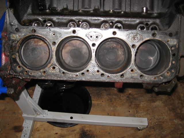

    Post  solo79 on Tue May 27, 2014 8:07 pm
    Updates: I got the engine tore all the way down to bare block. Not too bad and pretty clean inside. Found #7 & #8 with spun rod bearings. Mains were good, but I think the crank is toast. It's already been turned .10 and has pretty good damage from #7 & #8. The engine was clearly starved of oil since the oil pump catch screen was completely packed with carbon and other gunk. All rods appeared to have been hot. #7 & #8 will need reconditioning for sure. The bearings in those were completely destroyed and wrapped around each other. I'll have to take all rods to get them checked. Looks like I might be able to get by with a simple hone and new rings without boring, but won't know until I check the gap with the ring and put a micrometer on the cylinders. However, they're clean and look ok.
    Now for some pics:
    '79 Chevy Caprice 2-door then and now... - Page 4 IMG_1708640x480_zpsc10a2838
    '79 Chevy Caprice 2-door then and now... - Page 4 IMG_1709640x480_zpsd22bd71b
    '79 Chevy Caprice 2-door then and now... - Page 4 IMG_1710640x480_zps4eb2b198
    '79 Chevy Caprice 2-door then and now... - Page 4 IMG_1711640x480_zps6ec7ef26
    '79 Chevy Caprice 2-door then and now... - Page 4 IMG_1712640x480_zps5119f482
    '79 Chevy Caprice 2-door then and now... - Page 4 IMG_1713640x480_zps81bfd21c
    '79 Chevy Caprice 2-door then and now... - Page 4 IMG_1714640x480_zpsd409b9da
    '79 Chevy Caprice 2-door then and now... - Page 4 IMG_1715640x480_zpsbccbfc53
    Anyone know what kind of pistons those are? I've never seen pistons like this. Super low compression??
